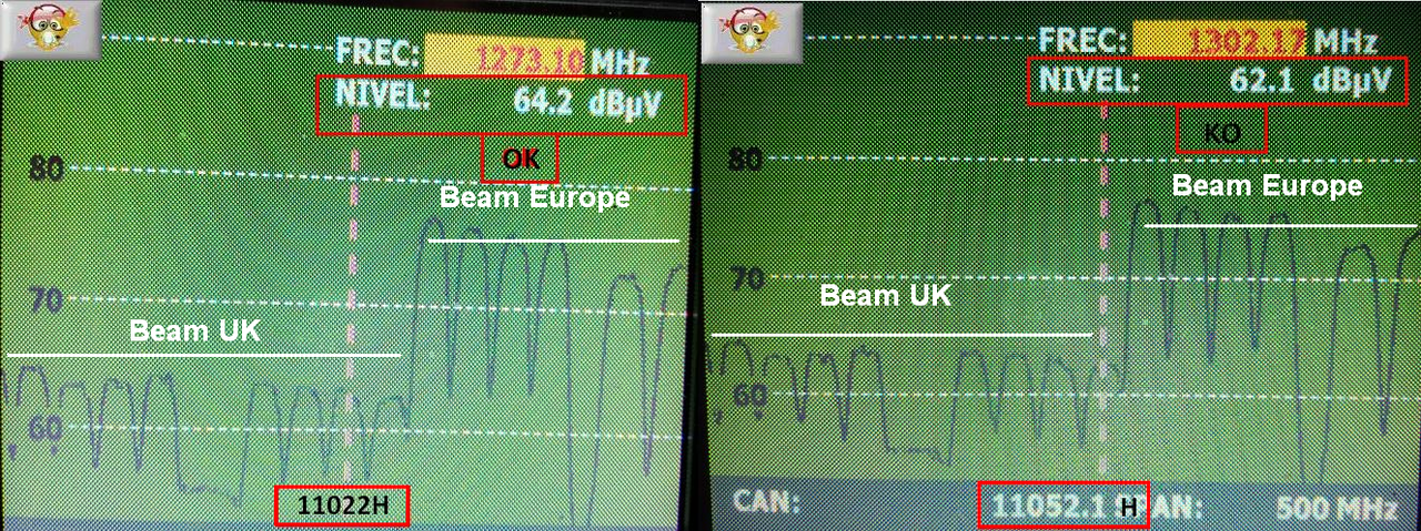

I put an old photo 2016, but valid to tell the same, from Madrid (Spain with 125cm antenna).
Referenced 2 frequencies/tp of the UK beam and the signal difference with the European beam.
Guess riddle, who disappears earlier?
For Madrid in good weather/bad weather, the criticism for disappearing, in this order.
11053 sticks with the adjacent tp (beam europe) pending adjust well, OK 8:00-9:30.
11023 threshold fec.
12382 telephone interference.
11068.
