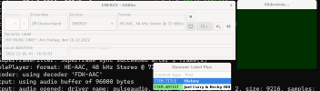

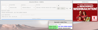

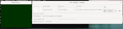

This week I've been using the HackRF on the other side, for receiving the DAB signal!
The two German national multiplexes on 23.5°E use DVB-GSE (12641.3V 1500 DVB-S2 8PSK 2/3), which is only decodable hardware-wise on some of the higher end professional-level DVB PC cards available. Those work because it's possible to dump out the raw BB frames (one of the levels below the MPEG-TS in regular DVB-S2, which for DVB-GSE instead contains network data). The DAB eti-tools then have a bbfedi2eti tool which extracts the DAB ETI frames from this baseband data.
This means, if you can get the raw IQ data using a software defined radio, it's then possible to use a software tool called leandvb to decode the BB frames in software, rather than using an expensive hardware device.
This even works with a £30 RTL-SDR stick, but the high frequency used on 23.5°E meant I had to use the HackRF instead, as the RTL-SDR only receives up to 1766MHz, not the 2041MHz (12641-10600) required. Older RTL-SDR sticks based on the E4000 chip do apparently work as they can receive up to around 2300MHz.
I dug out my old Skybox M3 which has LNB loop out, so that I can power the LNB and provide the 22kHz as required. Then after a bit of work on filtering the input from the HackRF into an old laptop running Linux down to a 2MHz wide sampled file, I successfully processed it with leandvb to BB frames.
This file then decoded with bbfedi2eti and gave me the two German national DAB+ muxes, DR Deutschland 5C on MIS1, and Antenne DE on MIS2. Pretty happy with this, without needing any new equipment. :)
