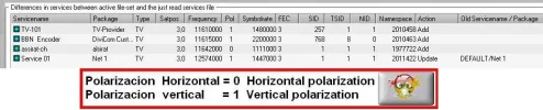

on Eutelsat 3B , 3E last 5 days i do not any more get signal on following frequencies ( 11496 H 2990 3/4 , 11500 H 2990 3/4, 11612 V 2220 3/4), i get excellent signals on all other frequencies on this birrd. There is no notification on Lyngsat, Flysat or King of sat that this channels has left this bird.
Tururu
Assembled with recycled parts
Jun 3, 2006
2,818
1,147
Recycled as the owner.
Those tp's are not active on Eutelsat 3B for Europe footprint.
Have a photo, nothing at 11496/11500.
Have a photo OK 11609 (DVB-S2).
Have a photo OK asset 116 614 (DVB-S)
But nothing in 11612 and I do not see it.
Esos tp's no estan activos en Eutelsat 3B para la huella Europa.
Tienes una foto, nada en 11496/11500.
Tienes una foto OK 11609 (DVB-S2).
Tienes una foto OK 116614 activo (DVB-S)
Pero nada en 11612 o no lo veo.
Ask again/Pregunto de nuevo.???
You use Dreambox600 for these searches. ??
Remember it's a DVB-S tuner, not valid for DVB-S2.
Usas la Dreambox600 para estas busquedas.??
Recuerda que es un sintonizador DVB-S, no vale para DVB-S2.

11496 H 2990 3/4
11500 H 2990 3/4
11612 V 2220 3/4
Reviewing the old canals of this position, had in memory you want, but do not see them as assets.
Revisando los viejos canales de esta posicion, tenia en memoria los que buscas, pero no los veo activos ya.
