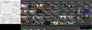

Signals have returned @ 42E 18710L, 18739L and 18774L.
dreamsat
Mar 23, 2018
1,203
1,771
germany
thanks @ SimonE
manny new programms:Y:Y

16,233
4,202
With my modded Saorsat LNB. (StreamReader's upper spectral range changed to allow a different LOF in selecting Inverto Ka in Crazyscan)
Not locking 18738L though :(

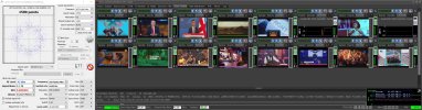

reception is stable here

dreamsat
Mar 23, 2018
1,203
1,771
germany
my scans
a little bit raining weater
