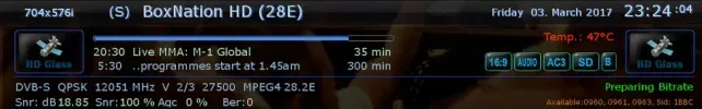

RimaNTSS
Jan 7, 2009
5,608
6,084
58
Some SAT-related hardware.
N-E from Riga
Looks like 8 vertical tps missing between 12051 & 12441, virtually all DVB-S2 QPSK
Do not know why they were not in list. Just checked:
12051 V - 18.85 dB
12070 H - 17.18 dB
12090 V - 16.19 dB
12109 H - 8.76 dB
12129 V- 10 dB
12148 H - 9.45 db
12168 V - 8.51 dB
12187 H - 9.45 dB
12207 V - 9.07 dB
12226 H - 9.40 dB
12246 V - 8.15 dB
12265 H - 9.87 dB
12285 V - 9.82 dB
12304 H - 9.45 dB
12324 V - 7.70 dB
12343 H - 16.39 dB
12363 V - 17.83 dB
12441 V (Not lockable.... UHD)
