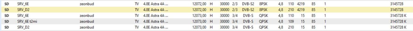

Hello everyone. I'm new here and I'm asking you for Astra4's T2MI channels. PID 4097 works! , but impossible for PID 4095, I tried everything and no image on the channels. Can you help me ?
I tried to modify the transponders in satellites.xml by adding the PIDs: the receiver only finds SRV D2 and SRV 6E and nothing else! I will post pictures it will be easier. Thank you in advance.
So start again - work through every possible issue & see if its definitely correct. We dont hold your hands & give you step by step answers on this forum - you have to do that hard work & most of the groundwork yourself. Its the only way to learn
