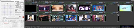

deeptho
Apr 7, 2006
703
423
Europe
Since my last report, I have not managed to produce a clean spectrum. However, I performed a "wet cloth over LNB test". The attached picture shows the before (with wet cloth - blue) and after (without wet cloth -orange), confirming that all the
spurious peaks remain.
I also managed to slightly align the feed and squeeze more SNR out of the 2 muxes
I can receive. It is strange, because I thought I had optimised this already as well as I could and also now it is raining,
which should negatively affect the signals. On the other hand, the LNB is poorly attached right now, and can easily shift.
So I will need to improve this.
