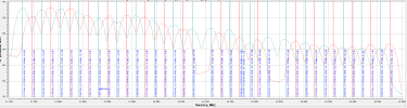

Reception status of Express AMU1 at 36.0E in my area

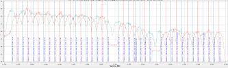

I scanned the AMUi satellite on 35.9E with the large antenna, not the Toroidal, to see if I could catch the transponders that disappeared a month ago.
Although the signal is strong on the muxes found, the missing ones cannot be seen on the analyser. This leads me to believe they're on the Euroasia beam. Is there anyone here who can pick up this beam in our area of Europe? Thanks.

I think that AMU1 is not yet able to electronically adjust the beam as the latest satellites can do.
But it can reduce the power to the broadcast antennas, which will drastically reduce the coverage.
Now it's probably 50dBW or even less only in the center of the beam. Although for 54dBW a 45 cm dish should be sufficient.
In Europe, the value may now be somewhere around 35-37dBW :(
In Voronezh, the level is only 10dB ( +/- 2dB ) on a small dish. Before, it was not a problem to reach even 14dB.
After the service night in July, even some transponders could not be received with original parameters.
After the next change parameters, they can be received even on small dishes distributed by NTV and Trikolor.
