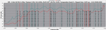

my reception with 2,20m
narrow-band radiotrasponder in the upper vertical area

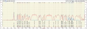

dreamsat
Mar 23, 2018
1,204
1,771
germany
scan in vertikal at 83.0° east
many transpoders with radio channels in the high earea
