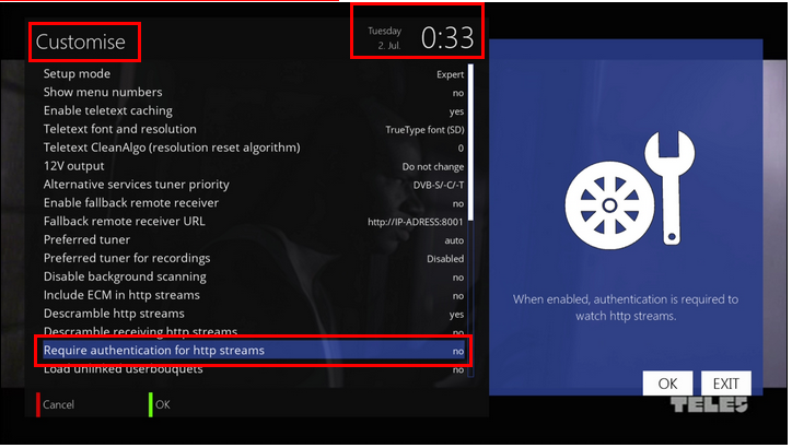

To enter the receiver, always ask passwd.
Another thing is to stream a channel, so do not ask passwd again.
Para entrar al receptor, siempre pide passwd.
Otra cosa es para hacer streaming de un canal, asi no pide de nuevo passwd.
Menu, Setup, Usage & GUI, Customise.
Require authentication for http streams..............................no
Openatv al instalar, no pide passwd, tecleas el usuario: root
Y entras al sistema, pero yo pondria passwd, es por tu seguridad.
Openatv when installing, does not ask passwd, you type the user: root
And you enter the system, but I would passwd, it's for your safety.
