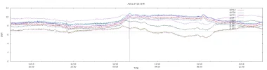

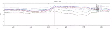

Currently it seem quite good reception of 2E/2F in SW of Finland with 5m dish (Dish pointed to 28.2E, not to 28.35) Here is 24h SNR valuegraph from some 2E UK spot and 2F UK spot frequencies:
