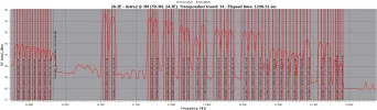

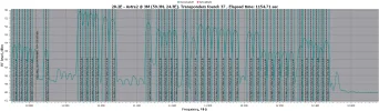

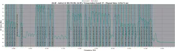

Here in Estonia receiving Astra 2E UK beam with 3M antenna is better then ever for one week now.
I can receive 10847V transponder at mornings. It was below lock here for one year and more.
10.847V.jpg BBCtvooHD.jpg CBBCoHD.jpg 28.2E-RFScan016febv.png 28.2E-RFScan016febh.png
