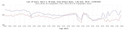

OW, ATM I have difficulties receiving 2E UK beam at all as reception at this time of the day is at it's minimum SignalMonitoring.jpg Besides, I've recently changed LNB to Quad and it is not performing as IBU single did.
