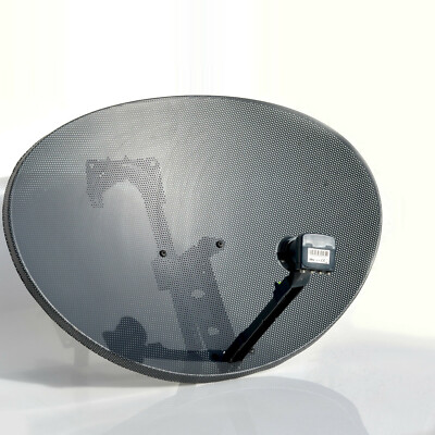

With a dish that old, I suspect that the cable(s) from it to your receiver might be damaged/deteriorated and that might be the cause of the glitching - could be a good idea to replace it completely and that might solve that problem.
As for the LNB, the nowadays-standard SKY Visionware quad isn't bad (I use one on a bigger SKY Zone 2 dish for another satellite and it works very well) - OTOH, I don't think that would fit your old SKY dish very easily.
Therefore, if you are up to fitting it, it might be worthwhile replacing the old dish with a new one, complete with a new quad, and new cables to totally "freshen things up"?

Yes ive read the sky mesh oval dishes are not very good. I am going to buy a new round dish, any suggestions on which one to get? Also what size? Would 60cm be enough in the south uk or shall i go for 70 or even 80cm one? What make and site to purchase from? Totally new dish lnb and wiring in next couple of months. Just need to find a good installer. Going to get a inverto ultra black quad lnb again.

Nothing wrong with a Zone 2 Sky dish & Sky quad LNB, from Amazon or eBay.

Zone 2 is that 60cm dish?

sky mini dish is more than sufficient 60cm or even smaller you can use any lnb as signal from this satellite is so strong.
If you get 80 cm round dish you can easily add 2 more lnbs for different satellites now or latter on.
eBay and Amazon are the cheapest.
for round dish inverto lnb is the best.

So any 60cm solid round dish for uk sky or a sky mini mesh oval dish and inverto lnb should do the trick. What about a dish from world of satellite?

As others have said (quite clearly!) a standard solid SKY Zone 2 and Visionware quad LNB will be more than adequate almost anywhere in the UK (and certainly in the Midlands) - there's absolutely no need to get a more expensive "round" 60cm dish & an Inverto LNB, AND it will probably be slightly more difficult/expensive to find an installer who will install the latter than a standard SKY dish.
Since your profile suggests a location of the Midlands, why would think of installing a zone 2 dish ?
OTOH, a Zone 2 dish will gather more signal than a Zone 1 one, and, as such will provide rather more protection against signal dropout in very heavy rain (AKA "rain fade"), and the UK is getting more and more of that nowadays! That's why I fitted a Zone 2 dish for SKY here in London many years ago, and so we've only had a couple of instances of momentary "rain fade" (and those were in absolutely torrential rain!) since then.

Sky zone 2 dish is the oval mesh 60cm correct?
35,616
8,581
The Raven Zone 2 used to be a 70x 60 design, but I have bought others before, one of which was considerably larger.
It seems whatever is not a mesh zone 1 is now a Zone 2 regardless of the origin.
My Raven mk2 zone 2 dishes measure 75cm x 56cm.

From personal experience, some Ravens are of 80cm width
