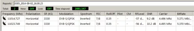

Has anyone else looked for the SIS feed on Eutelsat 31A at 30.8 east? Not seen it mentioned before.
It's coming in fairly strongly this morning, under the odd name of 'sam asked for this' and showing a testcard.
Parameters are:- 11.024H, 3330.

This freq has been in use for a while. Looks like they have changed the name.
And it's booming in here.

It is still coming in alright here.
TBS6925 100 cm Dish

EBscan got another one.It looks like the same one.
It is showing a different test card.
11014H 333o 7/8.
TBS 6925 100cm Dish.

11024 H 3330 7/8 DVBS -sam asked for this...:-rofl2
