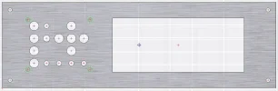

Hello dreambox1959,
I am currently still looking for a mounting frame for the display, so my further construction of the positioner has come to a standstill. Do you still have sources for the mounting frame?
best regards
suedschwede

two ways for a mounting frame :
cut yourself in a plastic box front face (or thin aluminium)
or buy a superb front face from schaeffer . that s what i do.
Schaeffer AG Frontplatten Designer
