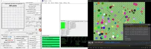

Until Q1 2020 this Intelsat can still be interested in besides the BBC package.Recently I discovered two transponders IP over DVB with TV /radio streams,namely:
11610 V,4374,3/4,Dvb-S2/8PSK,ACM,Single-Siminn Radiomidun: Pid-512,U:228.5.6.8,Siminn TV stream
11689 V,500,8/9,Dvb-S2-Irish Q Radio stream,six tracks.
Use PotPlayer to run the files.
The radio streams are interesting, what could they possibly be for?

I think most TV / radio program providers resort to this mode of satellite transmission for a clear reason. 1. The costs for renting such a transponder for streams is much lower than usual, and for that you do not have to have expensive equipment.2.These programs are addressed to a client, probably local(radio stations, residential centers, etc.),who also has the right equipment to receive such streams.And because of these reception devices dedicated to this type of stream reception cannot be accessed by a wider audience.Even we,as dxrs, find these streams difficult to detect.We're lucky with the dvbs apps we have,so we wouldn't even know these streams existed.
In fact streams with media content will be generalized and in the future will be the main mode of distribution via satellite, terrestrial, etc.At least that seems to be the trend at the moment...

Q Radio is a network of a few local radio stations in Northern Ireland. These satellite streams will be to feed their FM transmitters (with I guess six different local versions with separate adverts!).
Satellite is a fairly cost effective way of doing this. Just like the French stations on 5°W (11455H including some DVB-IP ones like these/11480H) and Spanish and Portuguese ones on 30°W.

And I've just checked that file you linked to with the Q Radio streams in. Sure enough they're the six versions of Q Radio in Northern Ireland (all of them except the Belfast version which is the HQ), so these are very likely to be feeding the FM transmitter networks.
Each PID is a 128kbps AAC stream as follows -
0x65    101    Q Radio North West 102.9 FM
0xc9    201    Q Radio Newry & Mourne 100.5 FM
0x12d    301    Q Radio Tyrone & Fermanagh 101.2 FM
0x191    401    Q Radio Mid Ulster 106 FM
0x1f5    501    Q Radio Mid Antrim 107 FM
0x259    601    Q Radio North Coast 97.2 FM
