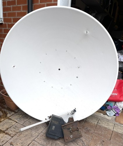

My Progress on my 1.2m CM Satellite dish setup

so whats the best size dish for feed hunting here in the uk? 1.2m, 1.8m, or 2m for picking up feeds that im currently unable to pick up?
Personally, I mainly use a 1.5m and on the rare occasions it struggles with a feed I use a 2.0m on a mobile platform.
I have found a 1.2m is OK and gets quite a few feeds but there are some it does not get that the 1.5m gets.
If you wanted to be getting close to receiving 100% of the Ku-Band feeds visible to a UK location I would suggest a 1.8m.
A 1.8m is probably easier to source than a 2.0m. It might be a question of what is available when you are looking around?
As you go up in sizes the requirements such as mount, anchorage and motorisation needs can change.
A lot can depend on how confident you are getting "hands on" with the equipment.
For the 1.2m and 1.5m dishes I have on Jaeger 1224 H-H motors they require practically no maintenance.

great thanks can u post pics of your dish please and where u brought it from thanks, i love feed hunting and want to do more in the future but im gonna need a much bigger dish for this and looking for suggestions and think yours maybe the right one, the easier to maintain the better, ill have a look at 1.8m ones
I bought the 1.5m brand new from Precision Antennas over 20 years ago. The company are now closed and no longer manufacturing dishes.
In an earlier reply I provided you with eBay links to motorised Precision Antennas 1.5m and 1.8m setups.

ok thanks yea i found them, do u think they are good enough for feedhunting? as they look old and battered

Provided the reflector parabolic profile is not damaged they will work OK

also would a prime focus satellite dish be good enough for sat feed hunting in the uk?
Please post your questions on the forum, you might get additional feedback and it may help others in the future.
As regards a prime focus reflector being good enough for feed hunting in the UK, Precision Antennas setups were used by broadcasters such as BBC, ITN, S4C, SKY and Virgin Media.
Quite a few of these setups will still be in use today. I think that may answer your question.
