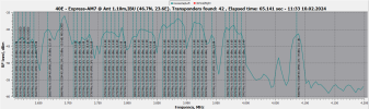

I tried several times to "blindscan all" the C-band at 40.0E with the 6909x card, but at some point, around freq 3900 MHz, the neumoDVB crashed every time.
However, with 6902se, the same thing doesn't happen, but it doesn't lock the signal on most frequencies.
I hope the attached files will clear up the problem.
Satesco,
It should not crash, but I think the signal may be too weak as well because there are CRC errors.
Can you try the newest version. If it still crashes, but also if it now works, I would like to see the neumo.log file.

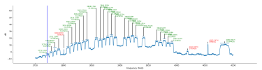

After updating neumoDVB, the 6909x card scanned all muxes without crashing (as shown in the picture).
Also, the app found pid 4096(PLP) and scanned and saved the found services.
Only when displaying them does the time to display a service take a long time, and if I insist, most of the time, the app crashes.
The problem I need to clarify would be:
1. if this happens because of the signal, which, although strong, is affected by interference and fluctuates. And this could explain, to a certain extent, how neumoDVB works, especially as the satellite's muxes are MIS-PLP(Russian boycott :oops:).
2. Are the display errors due to a problem with the video card?
I ask these questions from the perspective of an ordinary user, who does not know the "kitchen" of the application, but the errors reported at 40.0E, I have not encountered at 20.0E, also on a C-band satellite.
It's encouraging that after this update, the 6902 card did a "blindscan all" without scanning errors and found almost all transponders.

Test with another lnb, Titanium Satellite 5G(3.8-4.2GHz),anti-interference, with 6909x card at 40.0E.
This service can be played, but the same service in the package is repeated in Tune-add, and the app freezes.
It could be signal levels, but also some of these services are encrypted in rosscrypt, which appears as pixellated images.
Only with log files I can do anything about the remaining errors.

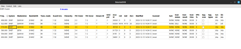

Oh yeah, i was wondering if neumoDVB only works for satellites? Does it work for terrestrial? DVBT2 in that regard.. i have TBS6920SE.. i’d like to scan like crazyscan2 does where it shows all the modulation parameters.. but since i run on ubuntu and not windows, kinda been looking for apps that could do the same thing..
16,234
4,203
Fine with DVB-T/T2.
Lists - DVB-T Muxes program includes DVB-T2.
In example, muxes listed before scanned.
This depends on the card/driver. Viewing works. blindscan works on some cards. spectrum acquisition is not implemented.
