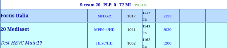

MOHAMED_OS
Feb 27, 2022
5
32
enigma2 & motor 30w to 52E
el eulma
12585 H
DVB-S2/8PSK
PLS Gold 262140
35500 2/3​

useless to insert a page when the most important thing is not there - the T2-MI pid value
<transponder frequency="12585000" symbol_rate="35500000" polarization="0" fec_inner="2" system="1" modulation="2" pls_mode="1" pls_code="262140" is_id="20" t2mi_plp_id="0" t2mi_pid="4646"/>
Edit: So I added it there so it wouldn't be so useless
