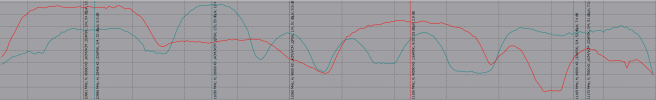

Is there any active frequency on this satellite right now, that can be scanned with a 100 cm dish in west europe?
3,894
5,903
@11° West C-band, RHC here - North Nottinghamshire. - 2.2mtr PF / Circ poloriser / Norsat lnb.
** 5G interference present at this frequency causing problems.
3662 RHC. 10806. 1/2.

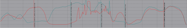

Man, I didn't realise that 5G caused issues elsewhere on the arc. Thought it was just the deep western side...
The worse could yet be coming CJ - these two gentlemen seen playing on their man sized cherry picker last week are only 300mtrs away down the road and due South of my 2.2 Cband. Not too sure what they are doing yet as they got 'rained off' last week but it could be another nail in the coffin for the bottom end of Cband reception
