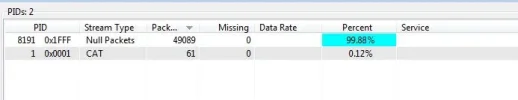

Just had a look at 25.5East.
Got a transponder.Not sure where it is from
11173H 4224 3/4. Empty.
Flysat has a near one 11171h
TBS 6925 100cm Dish.

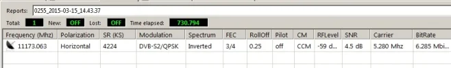

2,186
3,164
I might get wrong, but I think this signal-11173 H- is on Eutelsat 25B, not Mena,which has a pretty good coverage in Europe,as you already know.The signal is too strong for my dish to be on Mena!
Best Regards

Amazingly, despite tales of my dodgy motor elsewhere on this forum, the signal on 11173H is reasonably strong here despite my dish being on 26E with it being reported at 5.4dB with my TBS 6925.
2,393
3,408
That 11173 H data transponder comes with 7 dB S/N.
The FEC 3/4 transponders that I used to lock before, have become too weak since a couple of weeks.
Looking at Feedsat's scan (from France, closer to MENA beam), 11173 H has similar dB value as the other existing ones.
And combined with the reports from UK.
Indeed as satesco suggests, 11173 H might finally be on the Europe-friendly East beam.
Of course, with just a data transponder!

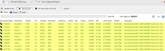

Mena beam Ku scan today:-
11142 V 27500
11566 H 27500
11623 V 2750025.5E_11623,978_V_27500_(2015-05-03 17.28.04)_dump.ts_000002777.jpg

Well, above are some quirky replies and comments on reception of this bird......no exception here. :D
As 'CJ' says in this thread:-
'Must be a really sharp cliff on its footprint as I haven't heard of anyone getting it in UK..'
bien sport 4k in november on 25.5e
Those frequencies highlighted are from 28.26ºE Astra 2G and no sight of any from 26.0ºE. :eek:
All dB's similar. Later will move a few 'steps' to correct and check results!
25.5ºE  27-10-2015  07.15hrs - Copy.JPG11046 H 27500
Astra 2G 11141 H 22000
11142 V 27500
