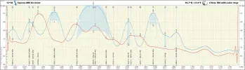

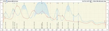

53.0E_All the transponders found in the high band(12500-12750 Mz) in my area right now.

Attached below is today's scan result table for 53.0 East.
I managed to lock most of the Fixed 2 beam frequencies but had no luck with the Fixed 1 beam frequencies. There was the faintest flicker of a Fixed 1 beam signal from 11044V but it was about as noticable as a fart in a hurricane.
All of the Fixed 1 beam frequencies that I locked were with strong signal levels and way above the level required for a lock. Nowt of note here, on to the next...
