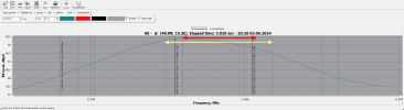

It's at a reasonable level but the spectrum shape is awful. At that level, I'd expect a decent SNR. I'm guessing that there's either something wrong with the TX or there's another signal close or on the same frequency.
CS gives all sorts of responses to the scan. It did show the right data rate once or twice.
Here's a feed from 29th May
1.8m PF dish.
Spectrum shape taken off Promax here in Central UK ... 1.2m CM, cheap pll Universal lnbf.

what is currently transmitted between 11650 and 11670 is absolutely not compliant with the requirements for interference-free transmissions.
As you can see from the IQmonitor spectrum, the two frequencies with their different SRs are overloading each other, which is not correct.
The Openbox S3CI II sees both frequencies clearly, finds programs on 11664 but nothing on 11659.
53°0E_2406020920_11600-11700 H.jpgEncode_1080P_108.mp4_20240602_093040.879.jpgEncode_1080P_108.mp4_20240602_093116.596.jpg

Running DATA on 11659 H creates a collision situation where one transponder interferes with another.
Therefore, some receivers have a problem with transponder LOCK.
Setting PILOT-ON for 11665H and PILOT-OFF for 11659H helps partially on e2 box.
<transponder frequency="11659000" symbol_rate="9000000" polarization="0" fec_inner="1" system="1" modulation="1" pilot="0" rolloff="1"/>
<transponder frequency="11665000" symbol_rate="10500000" polarization="0" fec_inner="1" system="1" modulation="1" pilot="1" rolloff="2"/>
