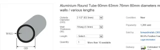

one reason i will be buying a lathe/milling machine you can do what you want then like trust 60.2 3.3 mm wall is near as dam it

If you want a Zinwell lnb OD 65 mm , fitting in the tube and a ID 65 mm feedhorn outside the tube , you need certain wall .

i cant see issue with thin wall who said it was issue ?
63.5mm OD with 3.3mm wall is 56.9mm ID, wall has to be counted twice to get ID
:-dohthis is true best leave the :dwinkies:alone now :(
