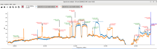

Here's what the upper band looks like now.
SatSearcher
Feb 2, 2007
321
262
West Yorkshire
Scan in the same upper band from my place In the UK.

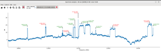

Signal tests with 6903x on Eutelsat 10A/10B under Linux.
