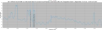

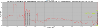

Here's my scan of the new Eutelsat 10B satellite in the Azores because I can't get a signal from ORTC TV but I get good Zap Viva Internacional with a good signal with 81%

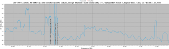

here in the east of germany are receive this transponders (3,7m)
