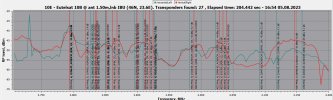

I explored the C-band signal and muxes on Eutelsat 10B with a 1.50m antenna. Compared to Ku-band, it seems better than Eut A, maybe because it uses the part with less interference (3800-4200 RL).
4147 R,68500,1/2,S2- Data, new

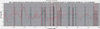

where is the location of reception?
2,189
3,174
In north-western Romania. Here is what I could receive in C-band from Eutelsat 10A in June this year.
I don't know if it matters what signal I had before, but comparing the signal with a 1.50m antenna between the two satellites 10A and 10B, beyond the massive interferences I have in my area, I say that it increased by at least 1dB on some muxes by 2 dB.
If you don't have interference, the chances of locking more signal/muxes on Eutelsat 10B increase enormously, even with a small antenna like mine.
