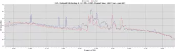

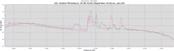

I'm receiving carrier on 11303V from 50...51°E position all the evening and right now, can anybody confirm reception in Europe? There are several satellites on that point, maybe another sat is active, I don't want to make mistake )

Not sure - could be Yamal making headway to 55E.

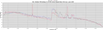

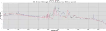

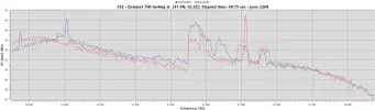

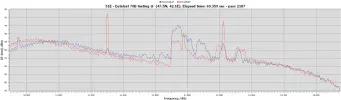

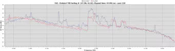

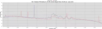

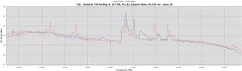

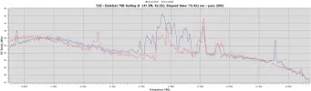

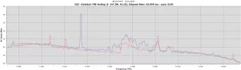

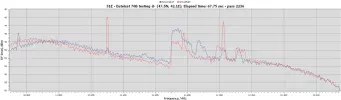

Today test carriers were active again from 51°E position, all the tests were repeated 3 times:
11303 V
11010 H
11350 H
11070 V + 11210 V + 11350 H + 12690 V

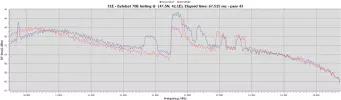

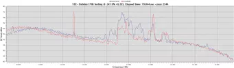

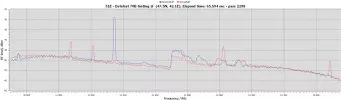

Spectrums of test carriers from 18 December.
Used frequencies (approximately, by the spectrum scale):
11570 H (wide-band carrier)
11010H + 11350H + 11430H (simultaneous test)
10950H (active only sometimes)

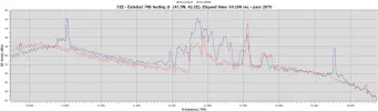

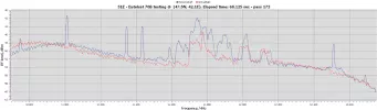

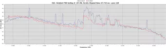

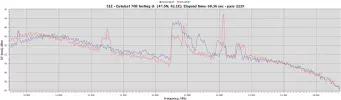

Spectrums of test carriers from 19 December.
11010H + 11350H (simultaneous test)
11440H
So, Eutelsat spent 2 days for testing of the same transponders, it seems strange.

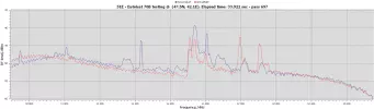

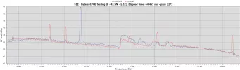

Today they test vertical polarization transponders, 11073V + 11303V + 12687V active right now.

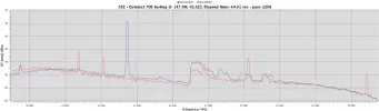

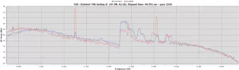

More spectrums of test carriers from 20 and 21 December.
Both days the same frequencies have been used:
Sometimes 11010 H was active.

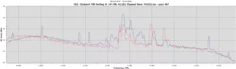

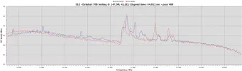

This morning they tests many carriers simultaneously. Right now active 11010H + 11347H + 11436H + 11073V + 11212V + 11303V + 12687V. The most powerfull signal for my location is 11436H.
Retired human
11,891
8,077
Are there any modulated signals or just carriers for now?

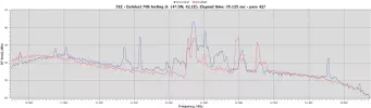

Crazyscans of 4 hours ago.
Activity in 11200...11700 and 12500...12750 both H and V.
Right now also the Arabic feed "Service 02" on 12736H 2600 is active.
