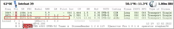

Small attempt on 62 East C band
so much with me is not possible .
Both transponders with radios
3869 L 1086 and
3872 L 2150 are read
3878 L 5573 with only 5,8 dB i.e. missing 3,6 dB
not read from GTcombo but seen
Of course, it doesn't help much, but it's something.
