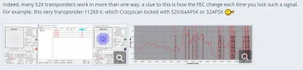

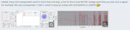

He finds with the blindscan of the SRs of 45000
we can add a transponder with sr 51420 but it does not lock it (these are data)
View attachment 143087View attachment 143088View attachment 143089
hi stephan have a nice day
may this will helps , some one successes to get 47000 .
also one more thing my friend had received this transponder from Eutelsat 21B @ 21.6° E
11268 V
DVB-S2X/64APSK​
7619 32/45​
but its very weak to looked
,satesco say
Indeed, many S2X transponders work in more than one way, a clue to this is how the FEC change each time you lock such a signal.
For example, this very transponder-11269 V, which Crazyscan locked with S2X/64APSK or 32APSK

For reference, Edision's Availink tuner locks this frequency without problem, it's clearly a tuner capability, not a receiver's one...
Mohd Sadoon
Feb 23, 2018
24
32
240 cm PFA - 180 cm PFA - 120 cm PFA
Coverage 14W - 125E
Oman
yes you are right , there are some receivers like Gt media v8 UHD also it finds MIS automatically like edision
