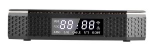

GTMedia GTX Combo is now available on Aliexpress, claims of 8K video and optional CI+ slots
