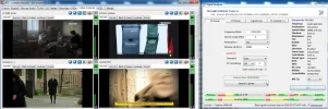

Is there a reason why I can't view the Ukrainian channels on 4.8 East with ebs pro and tsreader ? No problem of course with my sx88+

if EBSPro works with VLC, you can only see MIS 40 on 12341 because it is the only one that is not in T2MI.
For the MIS 30 or 12188 you need an additional program that can see the T2MI (I think smartdVB can do it).
Fot TSreader , no chance.

OK I see, I have 4T2 installed but can't decode any video but I use to. Btw with me TS analyser never loads ?
With 4T2 Content Analyzer, it works perfectly.

Codecs do not have much to do with T2MI
here is my setting
and I perfectly see the T2MI

12.187 won't even lock with me on 4T2, doesn't find anything. Any ideas why TS analyzer isn't working ?
Excuse me for asking you this question but:
Have you ever worked on transponders in T2MI with 4T2 Content Analyzer?
Or is it the first time and you do not know how it works?
I've used 4T2 before, all I know is that I have had video before but not now with this T2MI stream
With T2MI it's a bit more complicated.
Here is explained in picture how to do, to have a result.

@sat-tv-fan
Hello,
did you try to see the T2MI with the explanations I gave?
does it work now?
it would be even good to have a result.
I am ready to help when there are problems,
but if people do not use it, I stop right away.

Thanks very much, yes I forget you had to do something with the T2 MI tab, so I have checked 4096 and PLP 0 but I don't get anywhere really, no channels names and the connection from ebs pro drops as you see in the bottom left corner so I don't understand this. the pie chart on the right keeps disappearing also so I took a screenshot from my phone to show it when it does appear, all very weird
