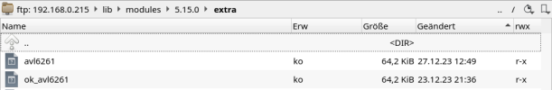

Copy the driver to this location (don't forget to set file permissions 755!), first rename the original driver to keep it.
The "e2_changes_20231223.diff" must be recompiled with enigma after patching.

it works with all image or only with openvix?
Driver should work in all images if kernel 5.15.0 is used.
You see that in driver path /lib/modules/5.15.0/extra/
Reboot after update driver (not just enigma2 restart)
In latest OpenVix image (without enigma2 changes) you should see unlocked signal briefly in signal finder. Only after enigma2 changes it updates continuously. Enigma2 changes tested only OpenVix
