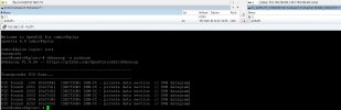

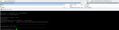

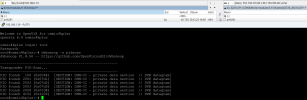

stephan94
Jun 30, 2008
937
1,536
Bavaria
The Ocean 04 improvements work perfectly with the TNAP-5 image from El bandido
with a universal LNB 10492 is received,
non-locked signals are indicated
SRs below 1000 are now received (I don't yet know where the lower limit is, maybe 500)
4,549
4,691
