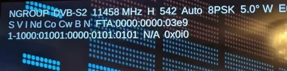

we need something in the 200 - 800 range to be sure....im happy to test if someone could point me to a lower SR TP
5,313
2,709
5 west 11458H 542 & 11465H 667
Manikm909
Small'ish Dish Man
Sep 10, 2020
2,488
1,172
Kent, UK
coming in loud (Octagon SF8008) and clear at 16.5db, its a shame the blind scan doesnt go lower than 1000 in E2
5,313
2,709
16 east 11078H 176
Manikm909
Small'ish Dish Man
Sep 10, 2020
2,488
1,172
Kent, UK
neither my SF8008 (E2) - nor my SX88 (non E2) can lock that one mate - not sure if its just a signal issue or an low SR issue

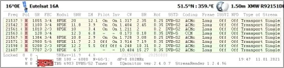

4,554
4,710
The TBS6903 DVB card can blind scan in very low SR.
I have attached a spectrum and transponder list below from a blind scan of 16E.
The blind scan locked the frequency of 21,563 with SR of 128.
