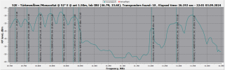

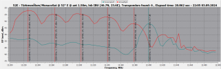

Someone might be interested in the signal at 52.0E in my area.
