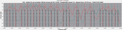

Nova and/or Vivacom are fine in my area, northwest Romania, with a strong signal.
Only on 12539 H, I couldn't find it because I don't know the parameters.

@satesco what size dish are you using please? I'll add it to the map.
2,180
3,159
I got the spectrum/signal at 13.0E posted above with the 1.10m antenna and IBU lnb,(but I also got a signal with the T90 toroidal antenna.)
