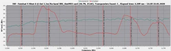

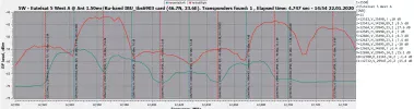

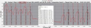

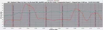

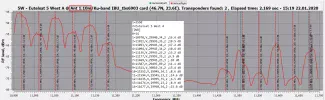

Tests done with 1.50 m and 1.10 m antennas in my area after MIS transponders were moved to E5WB.
