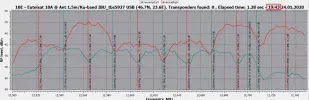

I just checked 12627 H now and found both MIS(all tv) are active(encoded)! I must add that the signal is dropping in the evening.Those who are at the edge of the spot or have smaller antennas may have problems with locking the signal.Need a sensitive tuner.
added:
