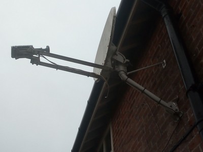

Is it possible to use just the RX part of a TOOWAY LNB like this one ?

The Viasat/Tooway that you show is not easy to modify for other uses.
Search the forum for "Gilat". John, Dreamsat and others have posted lots of info regarding modifications of Gilat ODUs for sat TV.

The Tooway looks like the Viasat ODU. Has anyone actually got one of those going for sat TV?
