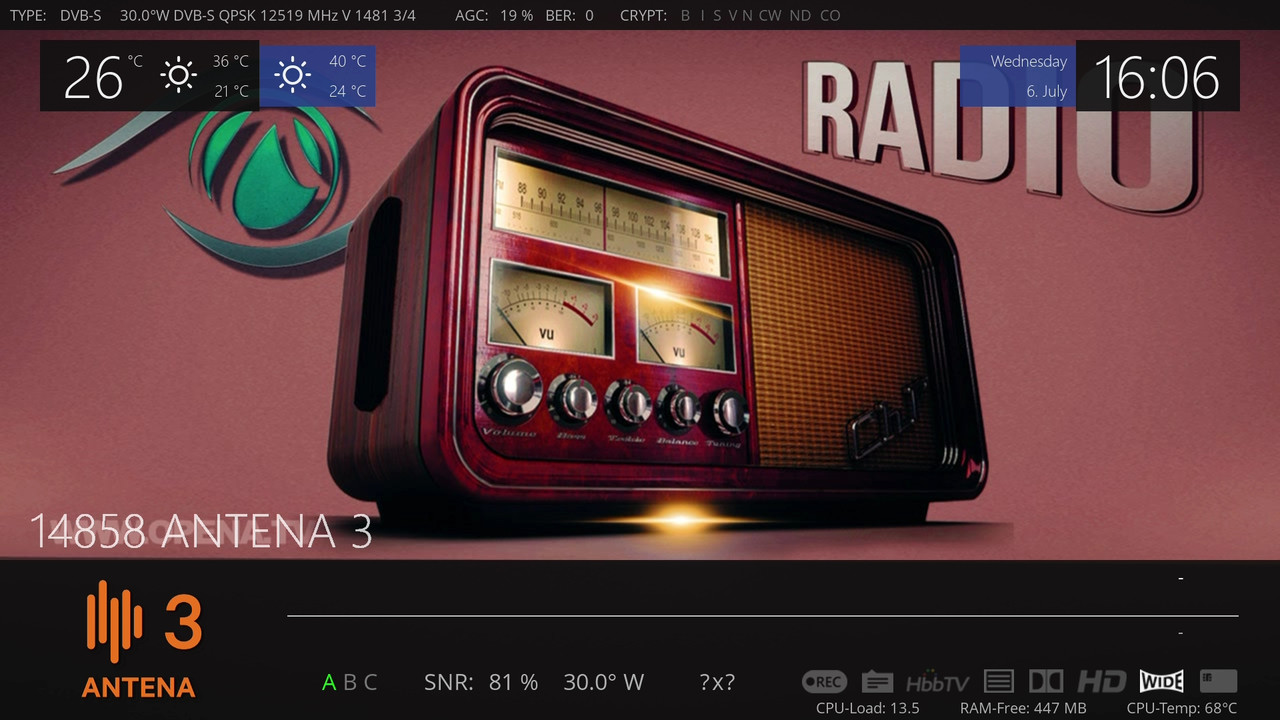

Adam, I have just checked 12519V for you. There are 9 AAC Radio stations as listed on Lyngsat. The symbol rate is 1481. 12530V 1041 locks but no stations found there. 12520V 704 won't lock here but there is a signal there. on the spectrum display.
Here's a pic of the three frequencies centered on 12520V
