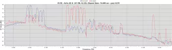

12073h seems to be active right now with very weak signal in my location.

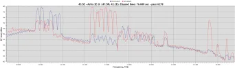

12056v is active right now
