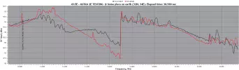

10870v
very low signal spot beam 0.5db

You can not see the signal cos it's demodulated!
could you explain? It could be any modulated signal but it's unreadable for my 5925. The only thing you could estimate from the envelope is the roll-off :)

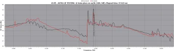

10818v
spot beam
1.5db

roll-off is the steepness the signal cuts off at both sides of the carrier.
The signals are modulated, however they use modulation types we cannot demodulate. They also have a loop of different constellations, they repeat all the time.
They use those signals to test the TWTAs.

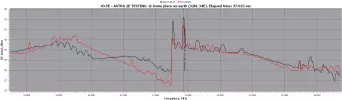

11710 H-the strongest signal I've had today from 2E.

got it in Kiev. It's also the strongest one from Astra 2E for today
