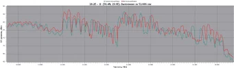

11005 & 11185 are zero in Kiev, and they are on Astra 1N PE1
I can't lock all of transferred freq from 2B(not to 2A) ,but I had lock on test signals from 2F. So these freq are on Astra 1N PE1 or Astra 2F beam has been moved to west
This how 28.2E looks like from Kiev
