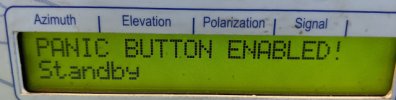

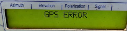

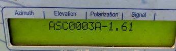

I found the controller for the SNG kit. It doesn't do much without being connected to the dish etc. If anyone has any info on the Sat-Comm ACS3000A controller connections, of which there are a lot, please let me know. I have the Garmin GPS that goes with it but don't know how to connect it.
When switched on it displays its version number, GPS Error and panic.
