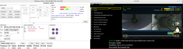

1,934
2,704
For Amateur Radio, you can use not only USB5927 but also the 6983/6903 card. You can also use lnb InvertoBlackUltra, not only with Bullseye, but with the settings in Crazyscan that @s-band mentioned(#4-above); the test below I did with the 6983 cards.
Also, with neumoDVB, one can view these amateur feeds. The settings with this app can be seen on #727.
