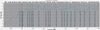

I don't know if the 1.50m antenna reception used at 83.0E in C-band in my area has any relevance for your region.
But as an idea, you might be able to figure out approximately to what extent you could receive at least a few transponders.
I used the Titanium 138 LNB, card 6983 and received in summer this year.
Actually, with any C LNB (I tried many), you could receive and lock transponders.
What's interesting and also encouraging about this C-band satellite is that the signal is much better (even stronger) than Ku-band. It's like it invite you to try it.

my scans with 2,20m and 3,37
At my location, this satellite is already fluctuating a bit.
