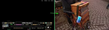

all Enigma2 receivers (with the right image) can use Openwebif to broadcast 4.2.2 feeds to the PC.
Here an example with the Edision MIO4K

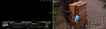

With the GTmedia V8 Turbo and the right tools you can achieve the same result
