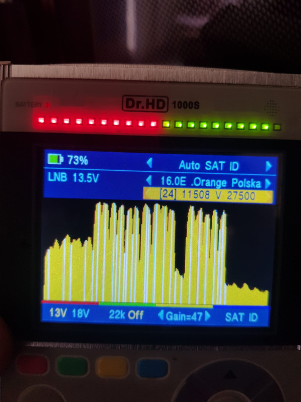

hello everybody
starting tuesday I have no signal (or a very weak on very strong tp) on all the frequency between 11350 and 11500 bith H & V on all my motorized system
I've tried to:
1) change lnb
2) connected a satellite meter directly to lnb
3) connected a satellite meter to the h-h motor
4) put aluminium foil on the lnb
5) put a baking sheet (according to my dish installer:)) in every direction near the lnb
I currently have inverto black ultra single
I've tried inverto home single and another ibu too.
I put a photo of my satellite meter spectrum where you can see such a "hole" in the frequency between 11350 and 11500
and 2 youtube link where you can see what's happened to tp that was very very strong (at least 15 db) on that range
do you have any suggest?
thank you very much I'm pretty disperate.
best regards

Do you see a similar drop in signal on 19.2E & 13E?

Post a clear picture of where the dish is pointing, down to the horizon.
If you can provide your postcode as well this may help nail down a known issue in the area.

surely you are in the transmission beam of some terrestrial point-to-point transmission that uses frequencies in use by the satellite
or some mobile phone antenna near your place of residence
Thank you i Will post some photos later
Anyway what can i do to solve this problem?
Thank you best regards
